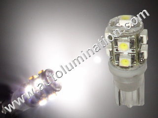

I have these installed and they work well, not over powering at all, http://www.autolumination.com/images...smt2_6k_wm.jpg
