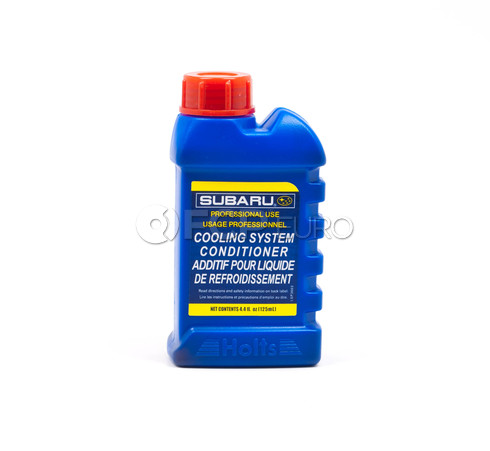

Don't forget to add some Subaru OEM coolant conditioner. I believe they recommend 2 bottles. It's cheap insurance.
2003 Outback H6 base
........Click 2 enlarge.........
