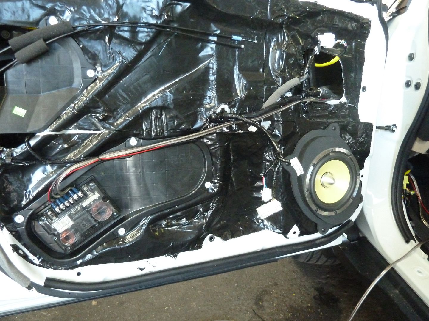

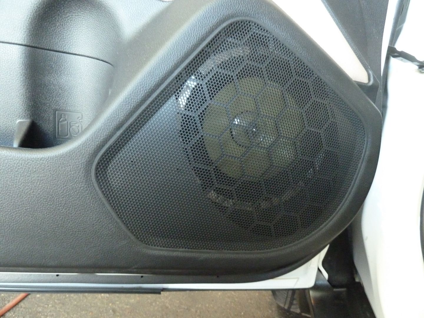

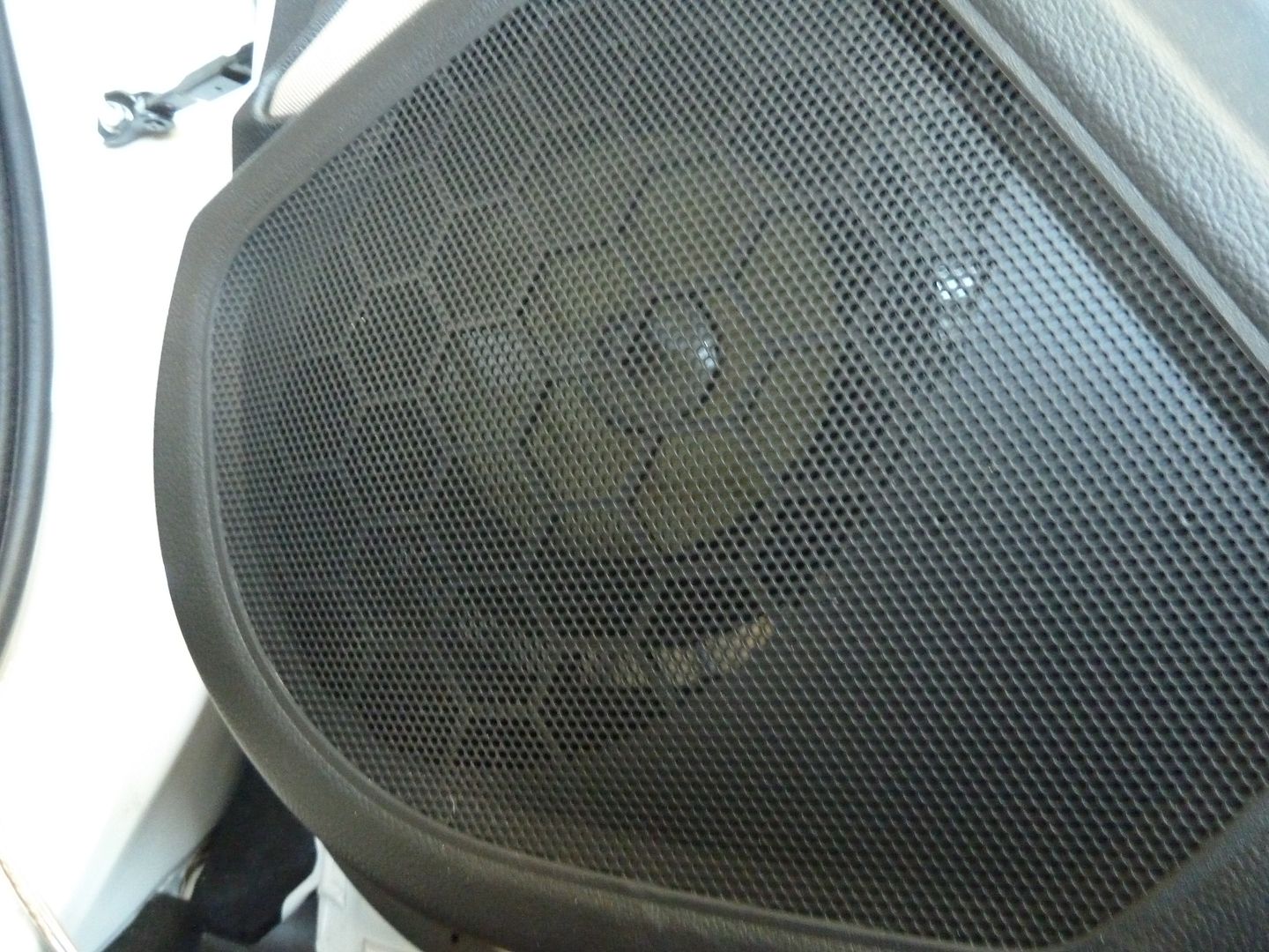

Did you go with the Focal Flax 2 ways? and is the tweeter really mounted near the midbass driver in the door as I see in the lower door photo?
Yes, the rears are the focal 165 flax 2 ways and yes, the tweeter is mounted as you see in the picture. So you could say that it is essentially a coax (which you could buy for a few bucks cheaper) but I wanted the separate tweeter/better speakers/crossovers you get with the 2 ways since I was powering them with a separate amp. As there are no rear door tweeter holes, I didn't want to create them so had them build out the speaker bracket so they could set the drivers back a bit so that the tweeters also fit within the factory door panel.

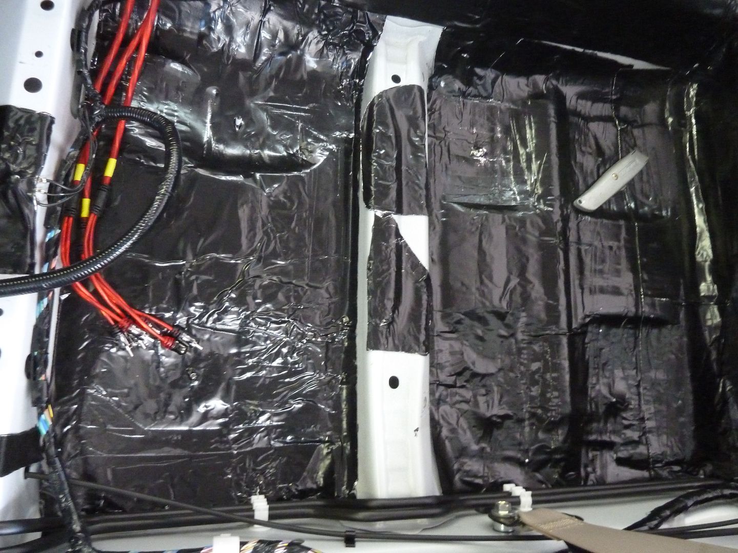

Here is what I ended up with: Focals 165krx2 fronts, Focal 165Krc rears, JL sub 10TW3, JL amp XD700/5v2, Audio Con Lc6i line converter with all new wire and a super custom built sub box. $3,000 the entire job installed and calibrated. I also had an adjustment after the 2 weeks passed...

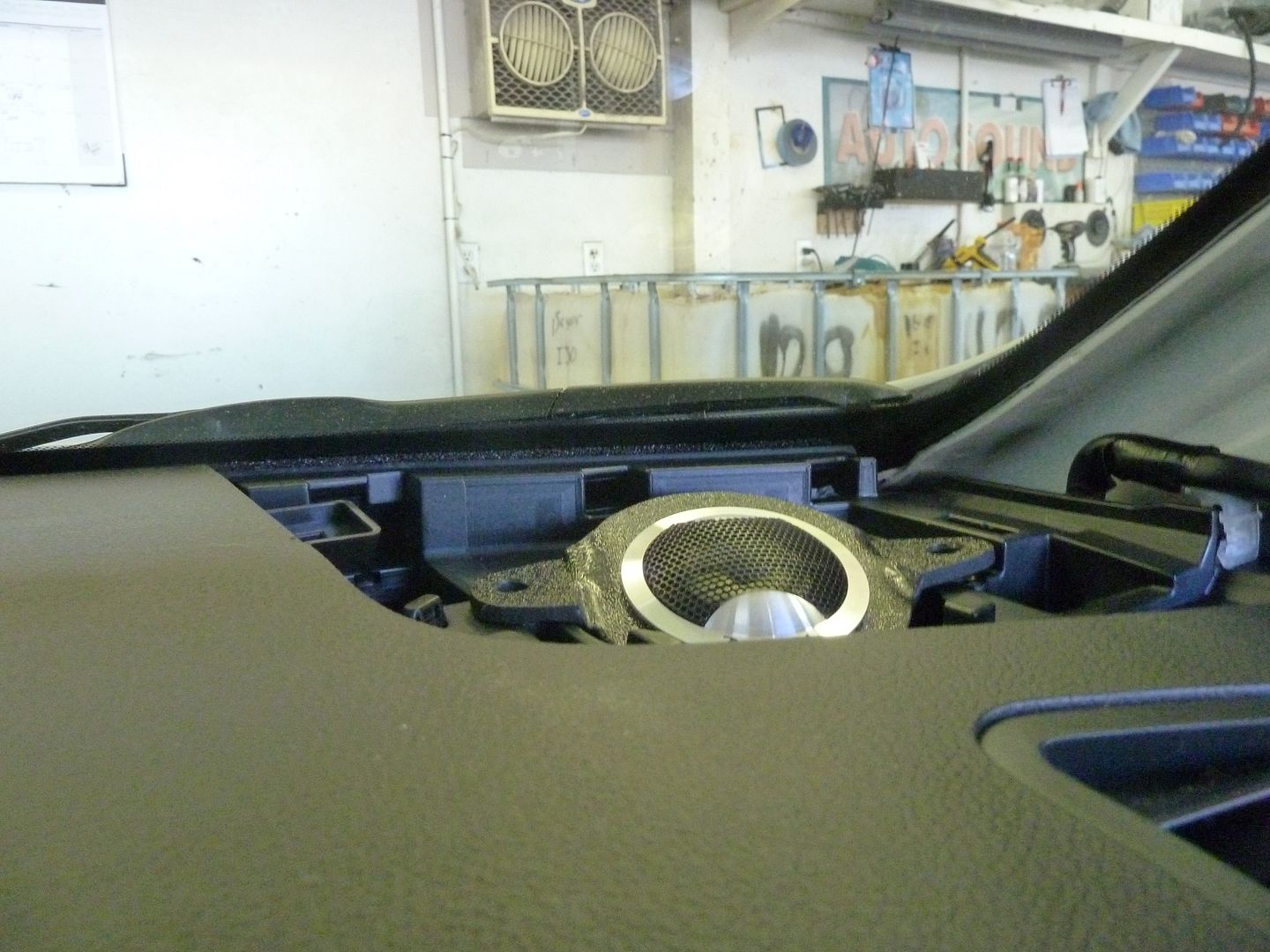

I did JBL GTO328 in the front and GTO938 doors; I figured I would see whether the 3 1/2 JBL dash speakers which are "full range" 2-ways should be wired as such or as tweeter only. They are convenient to use since they "drop-in" with the mounting tabs fitting the OB screw holes.
After much experimenting with the equalizer, my conclusion: better sound with just tweeters in the dash. (I re-used the blocking cap from the original speakers). Pretty impressive bass from the 6x9's, with the major limitations being the freq response of the head unit and the limited number of frequency bands in the equalizer.( a 12 or 15 band unit would really improve things as you could tune out most cabin resonances that are sound chamber effects, not just sheet-metal caused boominess that can be handled with Dynamat-type stuff..
Benefit: Although the full range 3 1/2's are probably $20 more than just a good pair of tweeters, no mods or special brackets are needed to just use them as tweeters.

I installed the subwoofer in the same location you did, however, your installation was a lot cleaner. They did build a sub box that fitted in the cavity of the original sub.
Picture to follow
