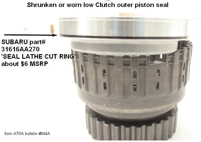

Hi. Unfortunately that issue has plagued a number of early phase II 4eat's. The typical cause is this shrinking seal:

Thanks Porcuipine!
So, I don't know much about these transmissions.
Does it have to be removed from the car to replace that seal or how is the fix performed?
Any issue with driving it as is? I'm not sure if it is getting worse, but from his description it is very drivable, just annoying.
