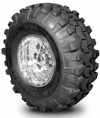

I would imagine a 225/65R16 (27.5") would fit with minimal rubbing. I run a 215/65R16 (27.0") General Grabber AT2 which has some pretty beef tread, and have had no rubbing issues at all. The 225, is about 1/4" larger in radius, so I think it would clear fine. We actually had someone here throw some 27" Super Swampers on a 2000 Outback, but they rubbed pretty bad.
