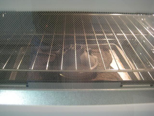

Preheat oven to 250F:

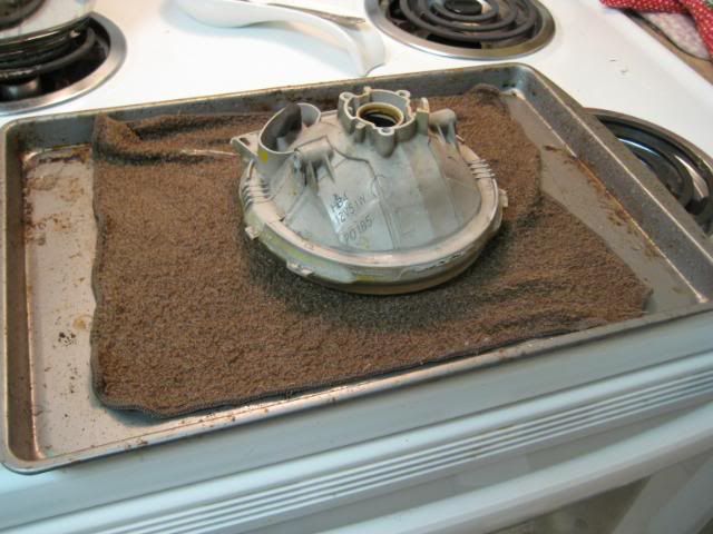

Place fog-light on old cookie sheet, and an old wet rag, glass lens down:
You could use new stuff, but that's on you to explain to the wife/GF.
Bake for 10 minutes:
Don’t get distracted and forget it’s in there, another good way to annoy the GF.

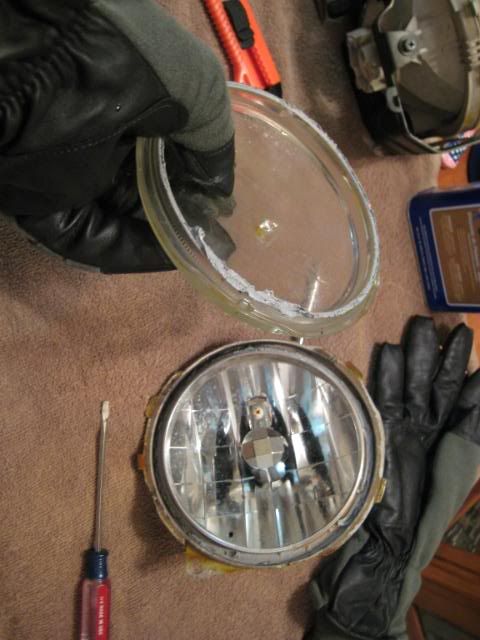

Prepare your operating table for the new patient:
In the end all I needed was a small flat head screw driver. Ok, so the fire resistant Nomax gloves were useful as well.
Insert screw driver in crack between lens and housing and gently twist, like your turning a screw.
Once that bad boy is off, it’s time to start cleaning. I had to remove glue and resin from all previous attempts at repair.
Now, that I can get to the inside of the lens, I can finally do a decent job of patching the bullet-like hole in my fog light lens. I think this clear JB weld resin will do nicely.
