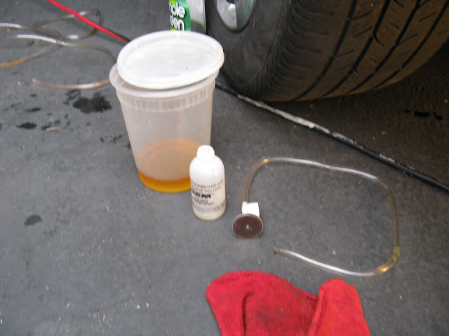

All you need is one of the autozone OEM DIY bleeder kits for $8.49 or make your own out of a jar with a lid and tubing to catch the old brake fluid and prevent air from entering the lines.

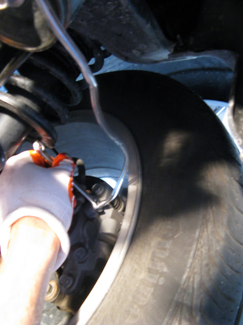

Remove the rubber bleeder valve cover from the Right rear caliper.
Attach your tubing to the valve. If you have the OEM bleed tool with the magnet, attach it to a spot higher than the valve. The wheel wells surprisingly had enough ferric compound in them for the magnet to hold (but I didn't try those till my second round.) Make sure the magnet has a good grab or the little bottle of fluid will fall as it fills.
A half a turn or so counterclockwise with your 10mm wrench.
Now it is time to depress the brake pedal 5-6 times. I used half pumps, because I read somewhere that you can damage the piston. Probably B.S., the service manual tells you to just pump the brake until there are no air bubbles in the tubing/brake line.
If you want to remove all the old fluid, you will probably have to fill the little bottle 3/4 the way up twice (maybe 15 depressions total.) If you do go for the clean fluid, make sure you fill up the cylinder after the first dump of the little bottle just to be on the safe side. You do not want to run your master cylinder dry or you'll be removing it and bleeding it then starting over if it is not destroyed. The Master must have fluid in it at all times during the flush/bleed process.

If you are changing to a different fluid or yours is old it might take a bottle and a half to get to the clean fluid.

Pump brakes several times and check to make sure no air is in the tubing. Continue until fluid is clean. Tighten valve with 10mm wrench when done.
Remove tubing and replace cover.
