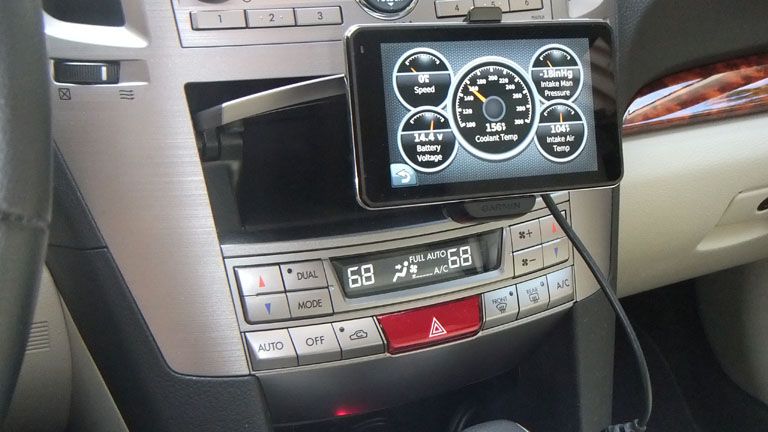

What the end results looks like.

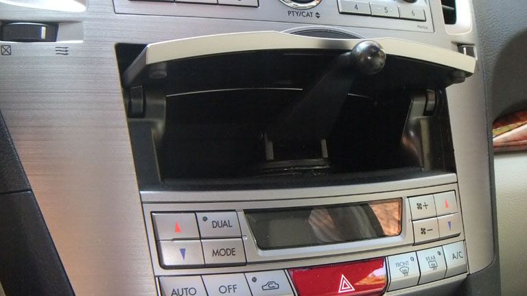

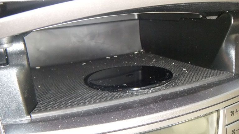

First I mounted the Garmin mounting disc in the cubby hole. These things never stick very well so I used epoxy to do this. After mounting I realized the rubber mat below the disc in the cubby hole isn't attached to the shelf under it so I used a razor blade to cut around the front of the disc and applied more epoxy there so everything is solid.

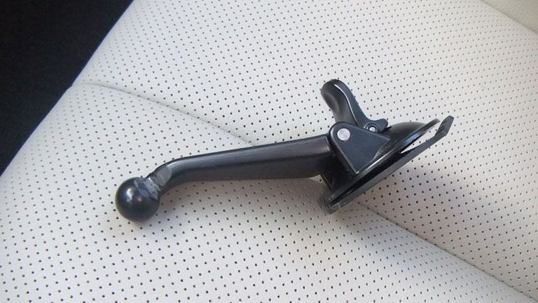

I then used the Garmin mount with the extended arm:

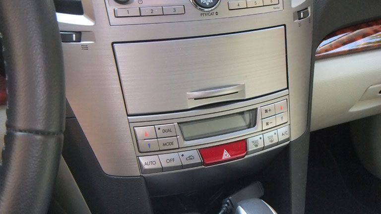

When not used everything looks stock.
