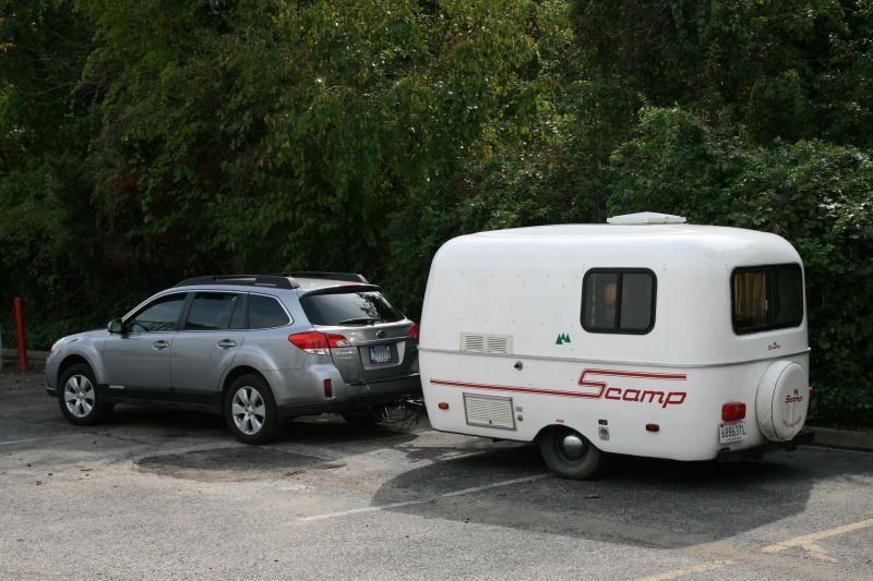

I tow this:
It is a Scamp 13. It weighs about 1,200 pounds empty... 1,500 ready-to-camp, and has about a 130 pound tongue weight, depending in how it is packed.
