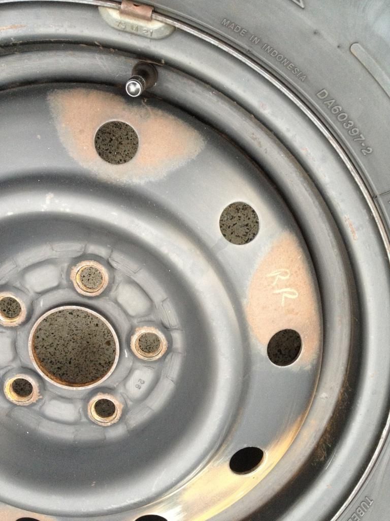

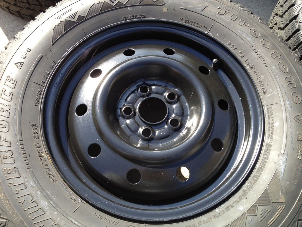

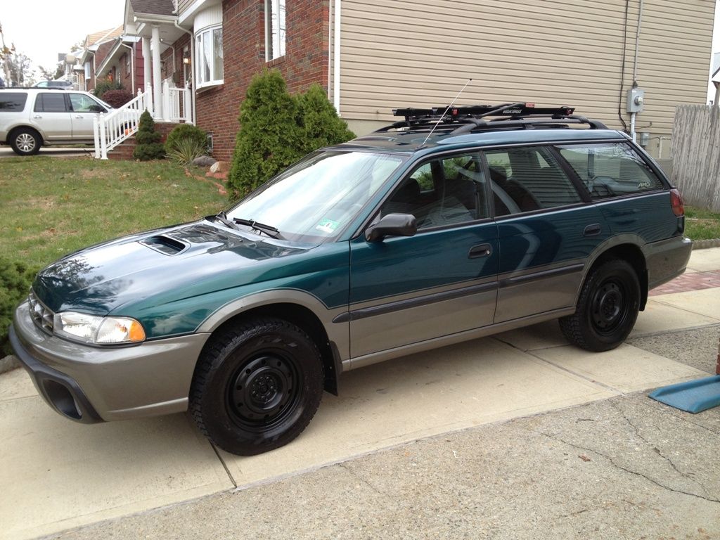

So I bought the products that I needed back in August and only really got around to finally painted the wheels in the past 2 weeks or so and here is the final product. Not perfect but came out better than I had originally thought. Hopefully the pictures get uploaded successfully... lol. I picked these steelies with Winterforce tires from a member on the boards here a few years back which I have in the Gallery Forums somewhere, but they needed some TLC.
The process was a bit long (at least for me since I get pretty anal), but I had a good time doing it. All said and done, everything took about 10 hours, which consisted of sanding, cleaning, priming, sanding misc spots, cleaning, painting, and then clear coat. Initially, I was going to paint them with the existing clip balancing weights in place but then decided to take them off cause a flat occurs or new tires are needed, it would have looked horrible.

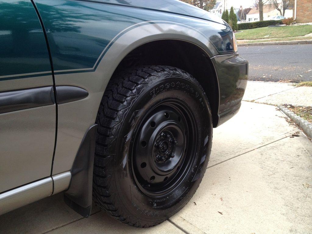

Also, before I forget, I made the tire place use the sticky weights on the inside of the wheel so that the wheels can keep a consistent clean, simple look. The Steelies are 15", so the weights actually came pretty close to touching the brake caliper. They have 1/4g and 1/2g (pretty sure it's grams) weights and I made them use all 1/4s as I think the 1/2s would not have worked since they are a bit thicker.

Products Used were the 100 Grit Sanding Block, 400 Grit Sandpaper, Wax and Tar Remover, Primer, Enamel Paint (High Temp), and Perfect Match Clear Coat (in that order):

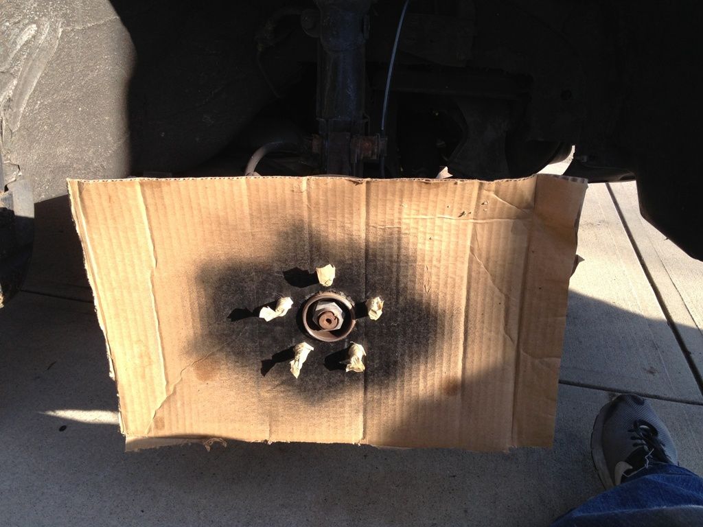

Ended up with extra paint, so decided to also paint the axle nuts so that I wouldn't have fresh painted wheels with new black lug nuts and then and rusted axle nut... just wouldn't look right, so I rigged somethign up really quick and pained them as well. I should have used Primer first, but just painted and that's it. If the paint comes apart, I can just do it again with primer... no big deal since it doesn't take long and I also kept the cardboard template.
Before (lots of rust in odd places as you can see):

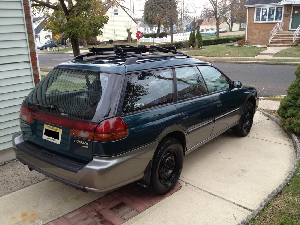

After (car washed and a little Meguiar's Tire Shine to keep the clean look consistent):
