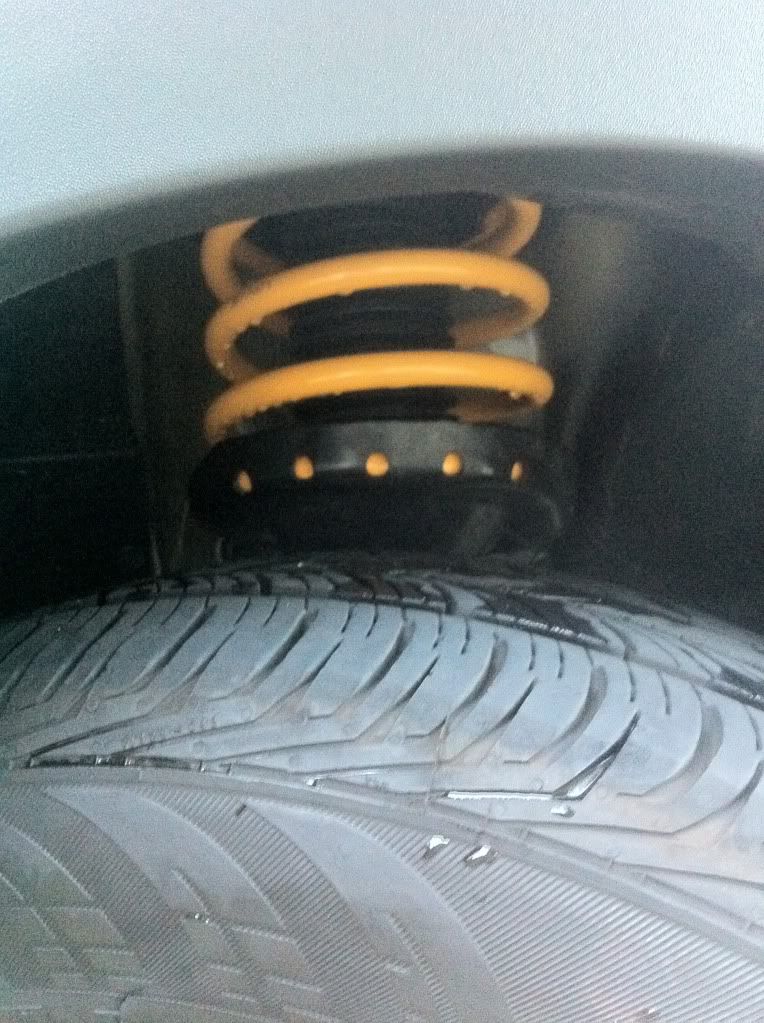

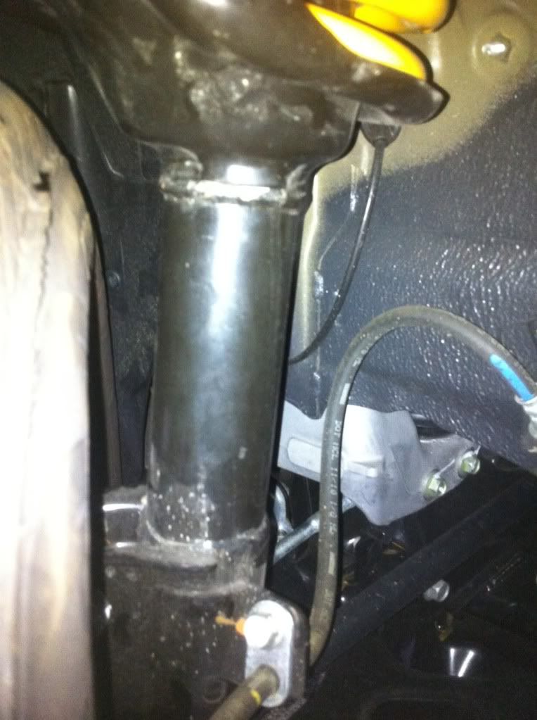

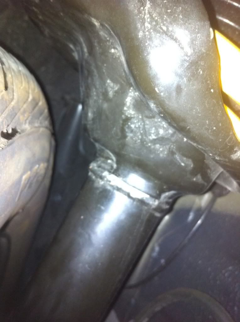

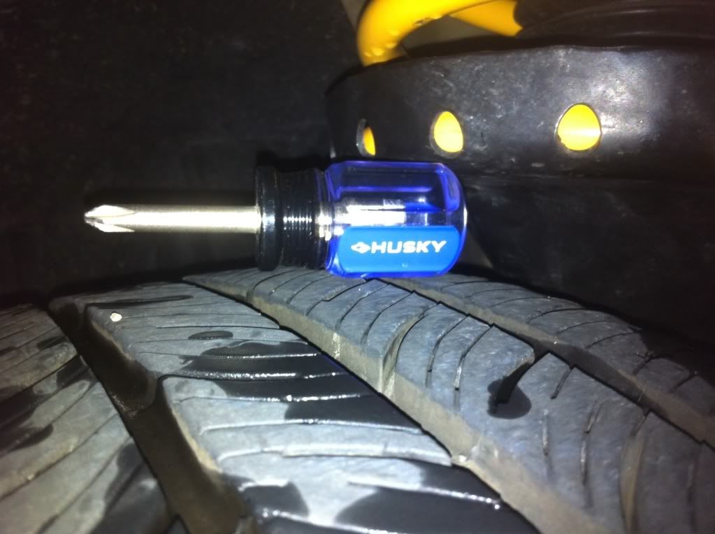

My understanding is the the limiting factor in upsizing tires is the spring perch on the Gen 4s. It looks like .5 inches taller would fit (but not much room left). Is this ok? Here are pics of the clearances between OEM 225/60 R17 and the perch. I may need new tires and would like to get 225/65 R17s if they fit safely.

You wouldn't get any rubbing on the skirts at 9 and 3 on the 4th gen?
I think I can squeeze another .5 inches in there- what do you think? :8:
Front:
Rear:
Will be close for sure.
