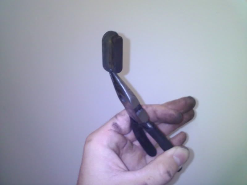

What I did, I pulled the lever up to the first click, adjusted the stars in the rear up until they wouldn't move, then moved it one 'increment' down. Did that to both sides. Couldn't detect any dragging when the lever was released. Screwdriver should work OK, medium needlenose pliers worked for me. The plugs 'hook' in at each end. you'll see.
