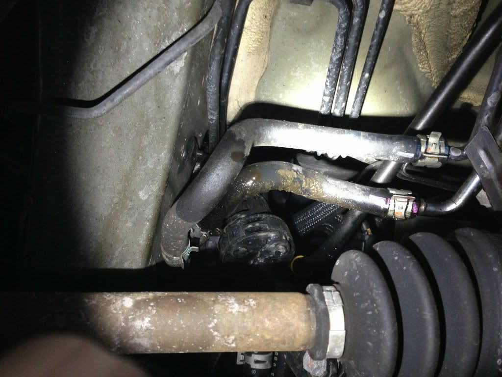

I picked up this 2009 Outback 2.5i limited from a good dealer in my area about two weeks ago.
I noticed some spotting on the driveway...
so i got out the ramps and went underneath and find some hoses leaking....
Drivers Side:
any idea what that could be?

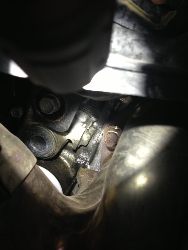

Then i also see a very clean drivers side head gasket! this is good, unless it was replaced and i was not told...
but, on the passenger side its not so clean:
I called the dealership service manager who inspected the car and sent him these photos... his answer is not sure what the hoses are, maybe power steering and it started leaking after driving the car seeing as it sat on lot for about 45 days. And he said the head gasket issue is just seepage that is normal to occur, but i questioned why on one side and not both, got no answer...
The hoses should be an easy fix but what about the HG? Is it bad head gasket? Or just normal seepage that won't ever be an issue as he assured me. (I don't believe him one bit) One more thing, when they sent me home with the car I noticed the next morning when looking over everything closely that the coolant in radiator was a few cups low and the reservoir was empty too! The service manager thinks that was just an oversight and will not be a problem.... but where did that coolant go??? i have a hard time to believe it just evaporated while sitting.

Those hoses are the AT cooler lines. What is dripping on them I cannot tell from the photos. The HG seepage does occur, I wouldn't necessarily call it normal, but apparently they do like to seep oil eventually on this era.

Known proof of some level of proper oil change history would help understand more about this car. 57K with very poor oil change history would contribute to HG issues. Clean it up good and keep an eye on it see if the leak is more obvious once you have a chance to see a clean surface and watch how the mess develops etc.
That hose pict looks like the top back of the fire wall near the valve that controls the hot coolant flow to the heater core? Could be a simple hose leak. Hard to say. But coolant leaks generally do not leave oily type spots on the garage floor.
As for one side vs the other? These engines have two sides two stand alone heads and gaskets one can leak while the other can be just fine.

I agree with subiesailor, clean the area really well and track it from there. You might try putting some white paper under the car overnight to see what color or smell the fluid is. Red=PS, Green=Cooling, Black=oil, etc. You might also have some drip down from the valve cover gaskets. That was one of my problems on my Gen 2, H4. Do the plugs have oil on them?
With a good light and some contortion you might be able to trace the hoses to one end or the other, using the component where they came from or where they are going as an indicator of their purpose.
The 2nd generation boxers (not sure about 3rd) have a history of head gasket leaks. Not as scary as it may sound. Most of them are external and can be as small as some cooling fluid dripping out near the firewall end on the driver's side.

Pictures aren't really clear...i'd like to see a good pic of the other head mating surface, like you got of the clean one. Hard to say but first glance I see lots of room for this being a couple things, not really definitive on the HG or not.
BUT in case it is HG's, here is what you need to know:
It is completely normal for one gasket to leak and the other not to. both should be replaced.

Both head gaskets look clean and well and the top sides, just the passenger side along the bottom as in the picture.
Was just looking at the hoses and they are the AT cooler lines. checked the fluid level and it is clean (it was changed as part of the service prior to selling the car) however it is high... is it being pushed out of the hoses because it is high and has to go somewhere as it heats up and expands?

The same two rubber ATF coupler hoses on my 07 started to appear "wet", but there was no dripping; they just accumulated dirt on them making it look worse than it was. The hoses were replaced under the extended, power train warranty.
The drops on the driveway appear to clustered in a row -- can you tell if they're under the left or right side of the engine? Can the location of a "new" drop help locate the source?
The photos of the lower side HG areas appear to be toward the front. If it's anything like my 07, the rear is difficult to examine, and especially the left side. I use an extendable 2-inch round inspection mirror with a flashlight to look at the back of the head/block joint, and around the bottom for a short distance (the engine mount prevents a full view). The drops might be from the back of the head/block area.
