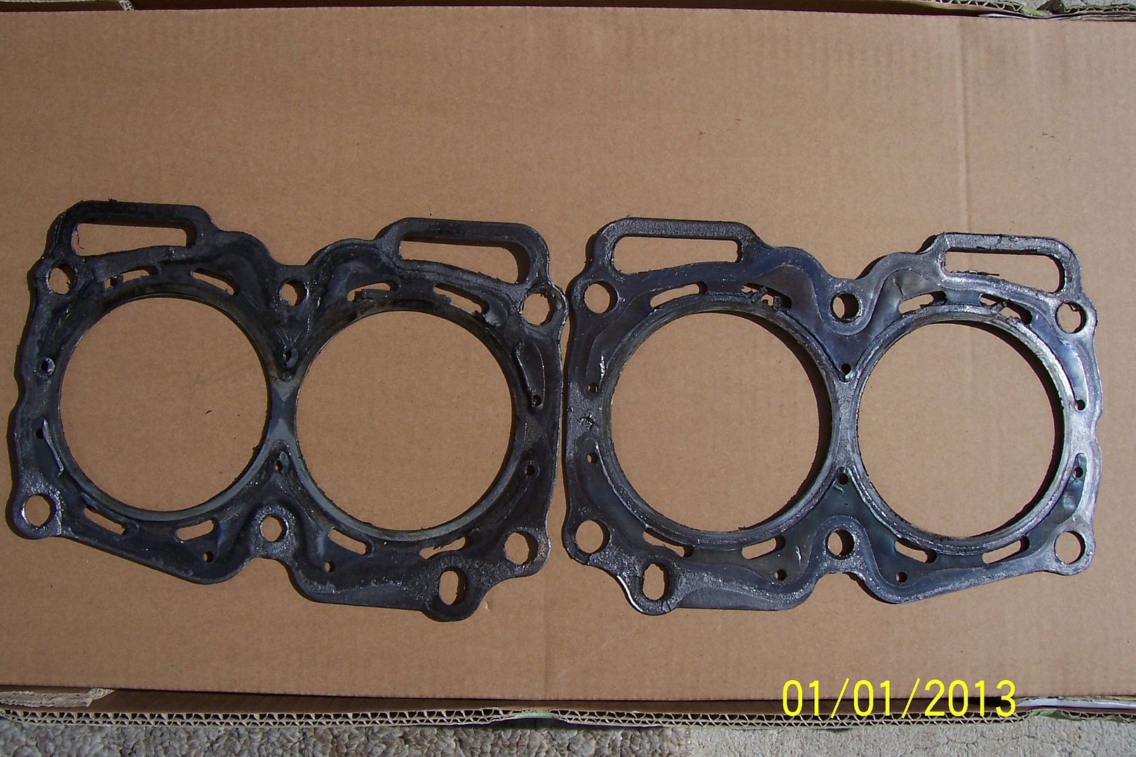

Picture of blown headgaskets
2918 Views 6 Replies 5 Participants Last post by  jbwood5
I thought I would post a picture of the aftermarket headgaskets that only lasted 1 year. This is no fault of Subaru since they did not make the gaskets. When I bought these and put them on, I was unaware of this web page and the discussion of all the inferior gaskets that are sold in the aftermarket. As you can see, gasket material was being forced from the area around the cylinder sealing rings into the adjoining coolant passageways.
I'm posting this as a reminder to all those who need to change the headgaskets..... Do not use the cheaper aftermarket gaskets sold on E-Bay, even if they say high quality MLS. They are not. As I explained on another thread, the heads were re-surfaced, block cleaned very well, and the torque procedure followed exactly as detailed in the manual. The gaskets I just installed are the newly redesigned Fel-Pro MLS product. I'll report if I have any problems, but I suspect they will be OK.

That's funny ... the Fel-Pro MLS gaskets I installed in my car have lasted over 4 years now and the engine has never run better or felt more solid. I call B.S. on your unsupported statements.
Just wanted to add that Cometic MLS headgaskets are also a good replacement, my Suby mechanic uses them only and has never had problems with them failing. My '03 just got a set of them in the summer and so far so good.

These are the newly designed 4 layer MLS gaskets that just came out this past year (if my information is correct). Although it appears that Fel-Pro used the same part#, the upgraded ones look quite different from the ones from a few years ago. I have not heard of any failures of the re-designed product. Here is an information brochure.

If I have to do it again in a couple of years I will. I've almost got it down to a 1 day job, but it is a lot of up and down, crouching and twisting.... and frankly the most time consuming part is cleanup and surface preparation. The 8 step torquing procedure is time consuming as well.
