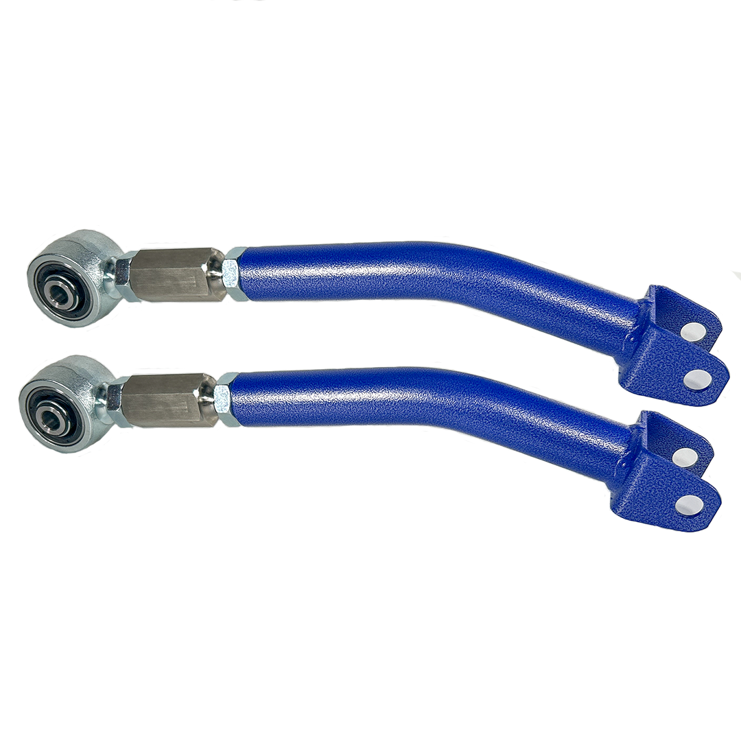

They're out there.
Adjustable trailing arms, too.
They're out there.

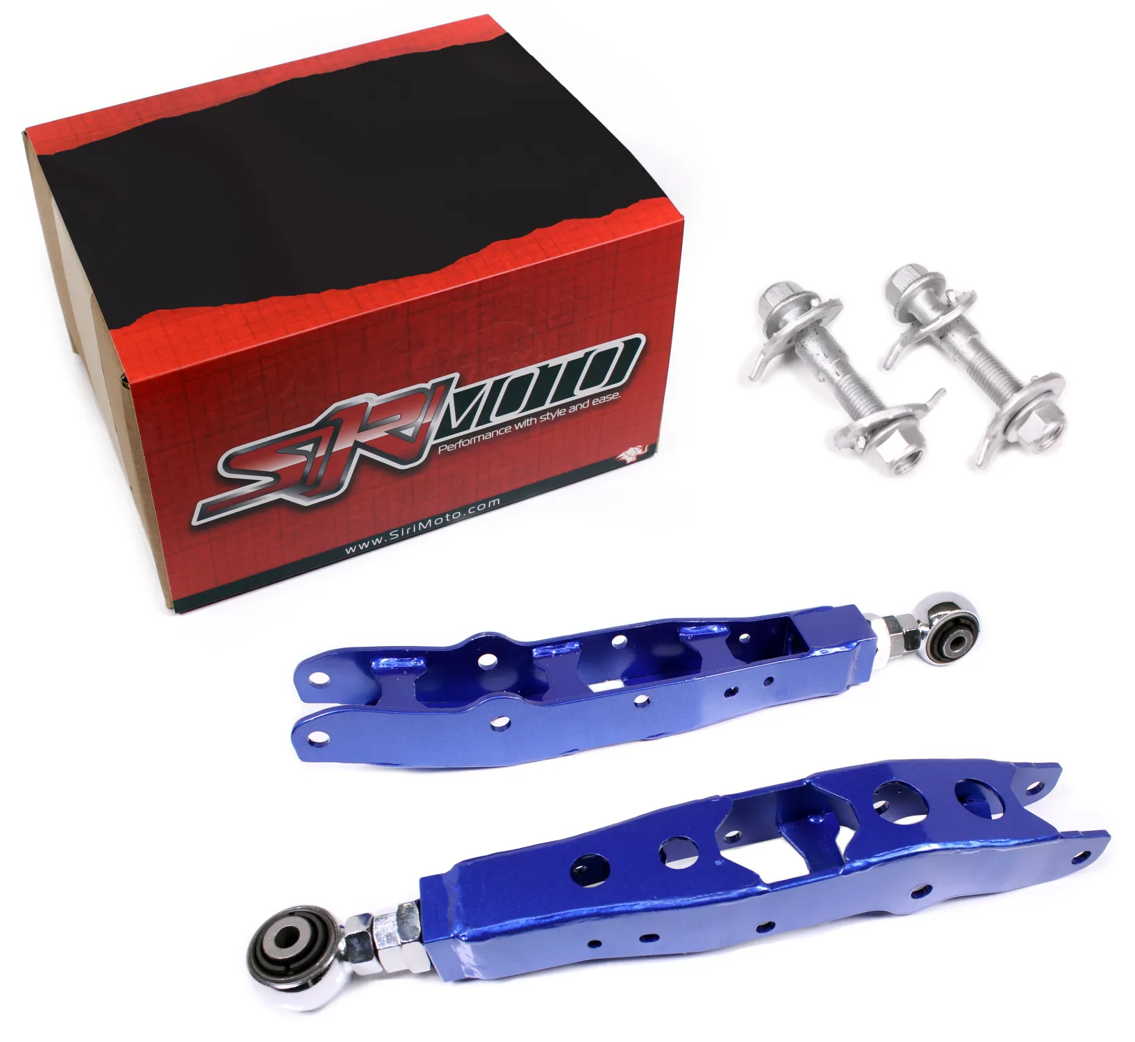

That's the ones I was thinking about & I looked at those to fix my negative camber at stock ride height, but, they state "This control arm is designed for OEM height and lifted applications only and will not fix the negative camber issue the Outbacks have at OEM height."
They also say that their "adjustable control arms are engineered to correct your suspension geometry back to OEM specs when lifting your Subaru."
I'm still looking for a set to help with my negative camber at stock/OEM height & any suggestions would be appreciated.
Thank you for the reply.
The arms pictured above resemble 2020 up, ( and 2019 Ascent). That style arm is what I keep coming up with when look for the rear lower control arm via Subaru OEM parts.
Gen 5 has bar style lower with a ball joint.
That same style above is what's on WRX, BRZ and Impreza.
Makes absolutely no sense why they list it up to 2019 and it's not the correct lower arm for 2019.
