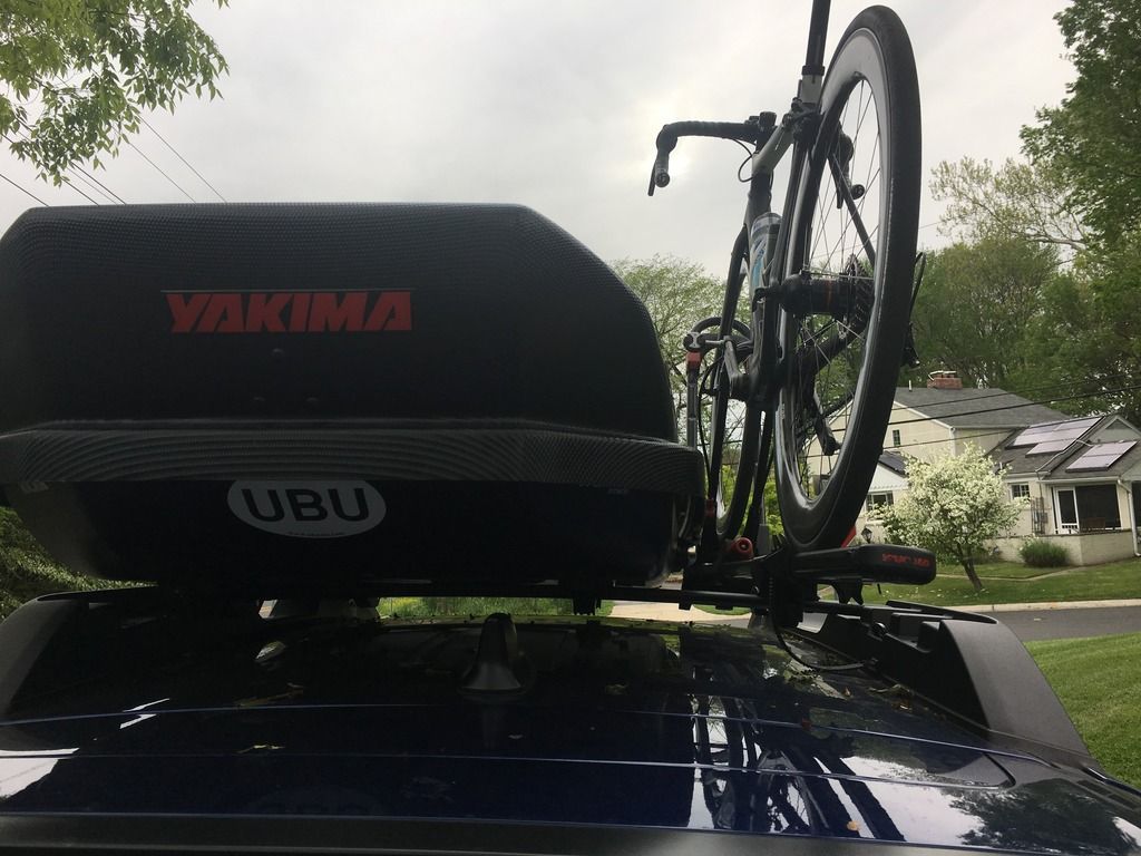

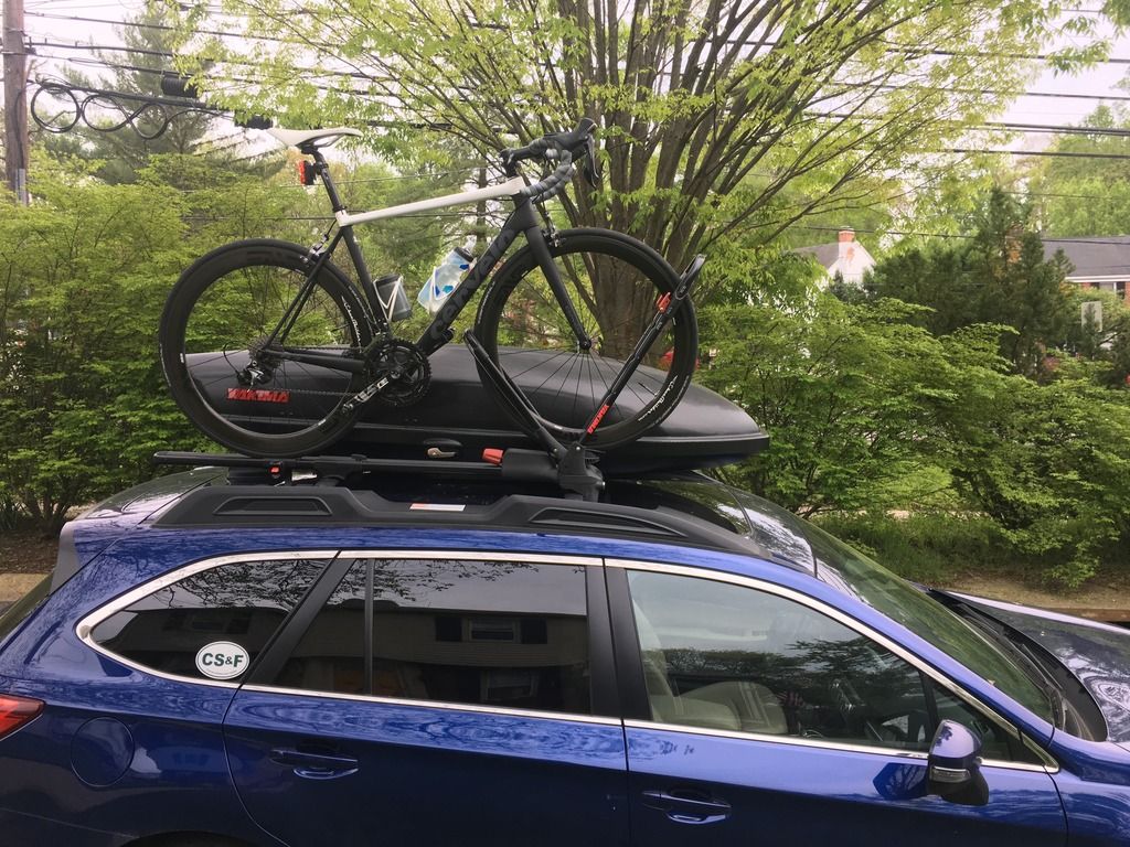

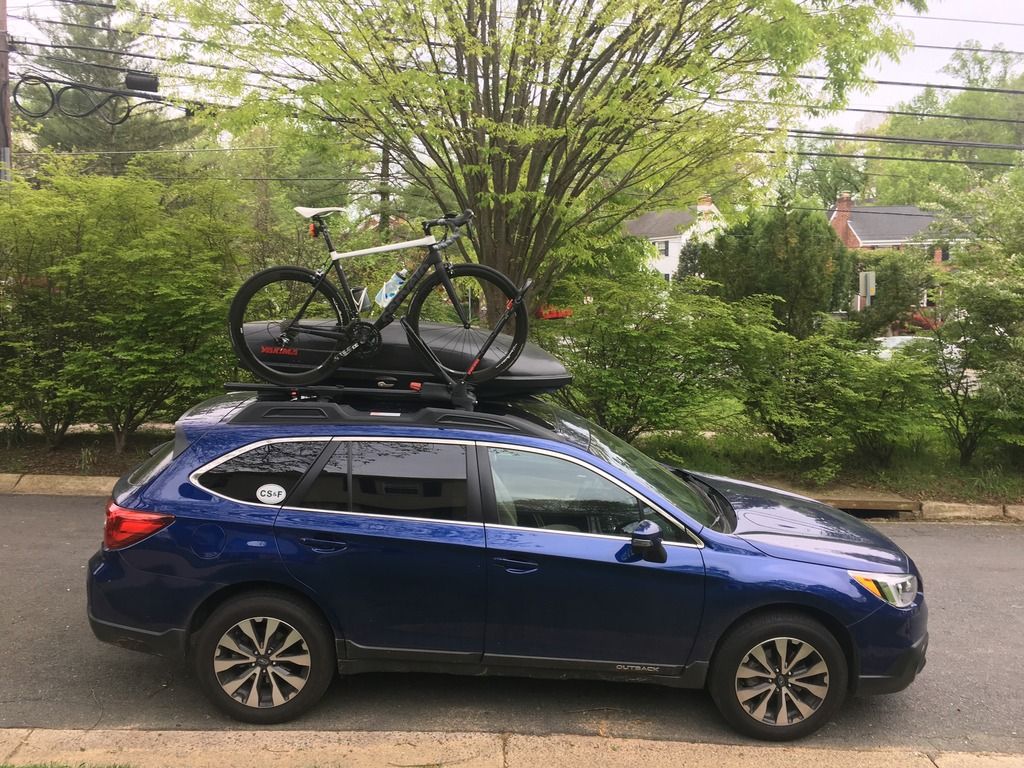

Skybox 16 and Frontloader at same time
So I searched all over the interwebs and couldn't find a definitive answer to this. Even the yakima amazon account said it wasn't possible. Anyways turns out it is. Makes me think a smaller skybox and 2 front loaders is possible.
I think we will end up going with the Landingpad 15's , sky-tower rack, and 70" bars so we can keep the Skybox 16 and have 2 bikes plus someroom for 3 when we reach that stage.

So a question, in practice, does the curve of the factory cross bars work OK with the bike being slightly at angle ?,
I assume you've had this up to speed on highways. One concern I have is, with a fork mounted/clamped bike, there's pressure on the fork clamping design. Not sure if this concern is mis-placed, but I too am contemplating the Yakima system.
Good to know that a bike rack could also fit on top with the box --- which bike rack did you get? Most yakima/thule that I see online are only compatible with round/square mounts.
Also - one downside to shifting the box all the way over, is that now you're virtually unable to reach undernearth the box when it comes time to cleaning your roof. May not be a worry for most, but I'm a bit OCD when it comes to keeping the car clean :)
