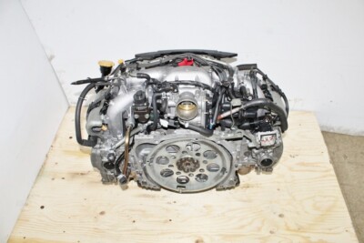

Hello, I have a 2009 which I only know it's a 2.5 manual. Needs an engine.
Looking for advice where to find one.
I was looking at some JDM engines which seem great, low miles plus the importers can ship them to me, as I'm not near any population center where I can easily look for a replacement in a junkyard or whatever.
Question is, anything I should know about or look for in particular, concerning compatibility?
Photos of "ebay says it fits" 2009 2.5 outback engines look the same as mine as far as I can tell.
I am sure I can swap the intake and things like that as needed, but heads are probably the big question, I would of course rather not have to mess with them.
Also I see AVLS and AVCS, looking on ebay, and I don't know the difference :) I suspect some of the listings have it wrong.
Also I think most (all?) are from an automatic, any problems putting one from an auto into my manual?
Thanks for any info/advice!
(note: I posted similar question the other day when for some reason I was thinking it was a 2003. No idea, brain fart)

Everything I can find about AVLS vs AVCS says these two engines are the same, and one must be mis-labeled as AVCS when they are both AVLS.
Also, they both look identical to me, as far as selonoid switch, timing belt cover, etc. Also they look like my engine.
Do you know these engines @cardoc? Mind taking a look sometime?
I could easily be missing something!

EGR question, I assume if my intake is non-egr, I just need to plug the hole in the head on a replacement engine that does have EGR? (also I'm assuming the "copper looking" pipe from head to intake is the EGR, I don't remember seeing that on mine).
