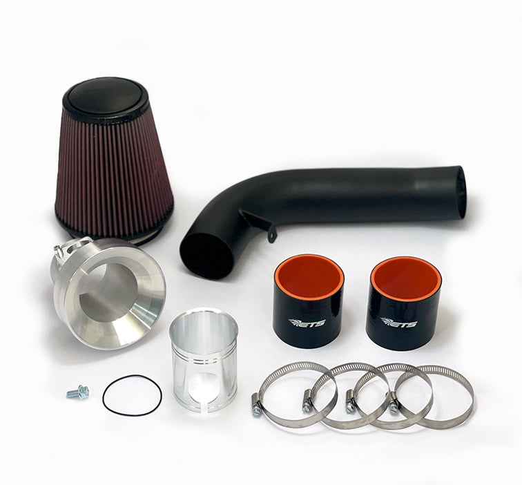

Looks like ETS is the first to market with an aftermarket intake for the FA24 in the 2022 WRX.
Who is going to be the Guinea pig and slap one of these suckers on their XT? :devilish:
Not me, I live in Cali! However I've seen many short ram intake systems that are counter=productive. My 2022 OB collects cold air from the front grill area. Some short ram systems suck air in from the hot engine compartment. Cold air is better that how engine compartment air as far as performance. The CAI above appears to have a box to surround the K&N filter, but where does the air come from? Inside or outside of the engine compartment?
I emailed ETS and they said that they’re pretty confident the intake tube itself will fit. However they are doubtful that the intake box/heat shield will fit. The shop I’m taking it to is really good with fabrication so I’ll report back what it takes to make the entire intake fit. I love testing out ETS products (Dyno test: ETS V2 header vs. KillerB Holy Header @33psi...) :)

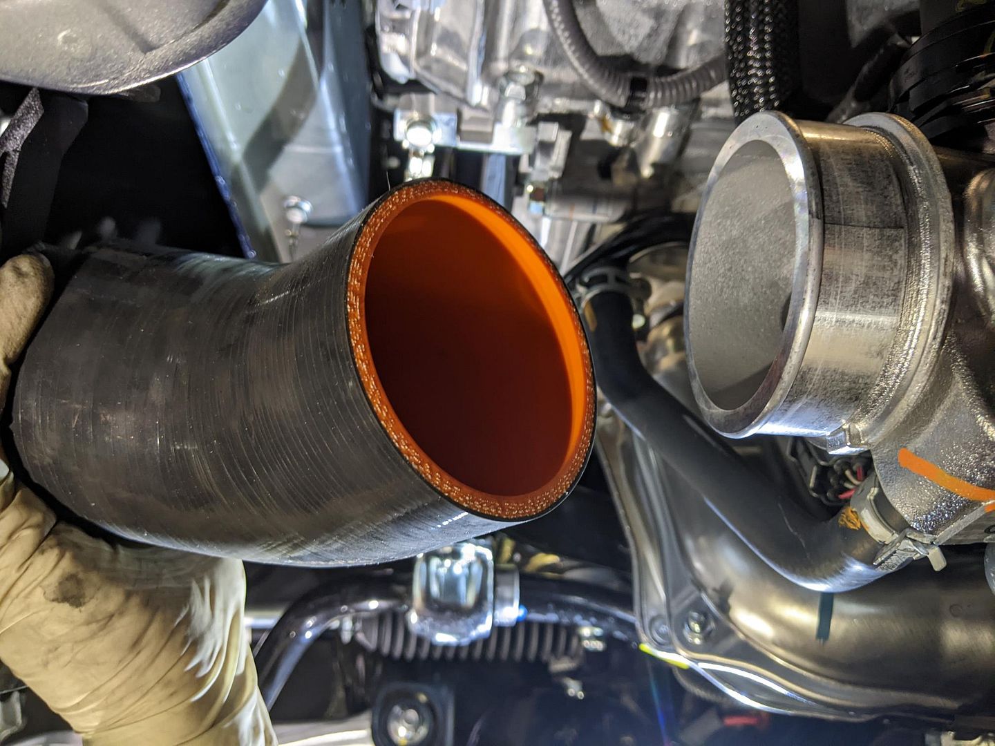

Bad news, intake came up a little short, we could get a hose to lengthen it but I don’t know if “no tune required” claim by ETS still holds true. I rather not alter the flow dynamics without a way to definitively protune that car. I’ll notify ETS as a guinea pig, return the intake, and patient await their Outback intake release. No turbo noises for now :(
#24 ·
That is a bummer! Thank you for keeping the community informed.
I believe that modifying the OEM Airbox is always the best route. Study it and look for options to 'open it up, or 'increase airlflow'. They manufacture the intake system to maximize within their parameters. I always look for spots that are 'under engineered' for a reason (safety & longevity).
