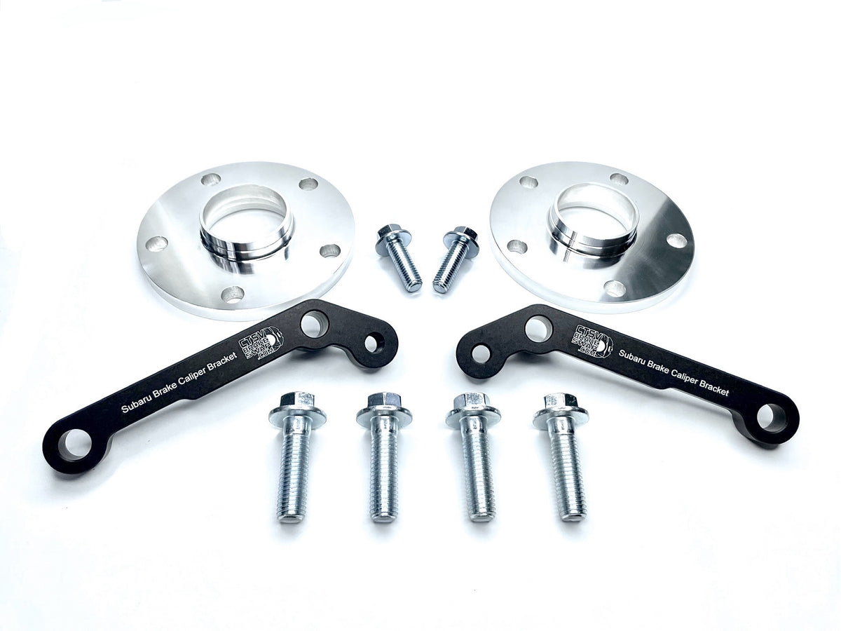

I have the ATS-V setup from CTSVbrakeswap.com that is technically designed for the 22+ WRX. His adapter kit matched the 6th gen perfectly. Only thing I can't answer is how small of a wheel can fit. I'm running 19x8.5
