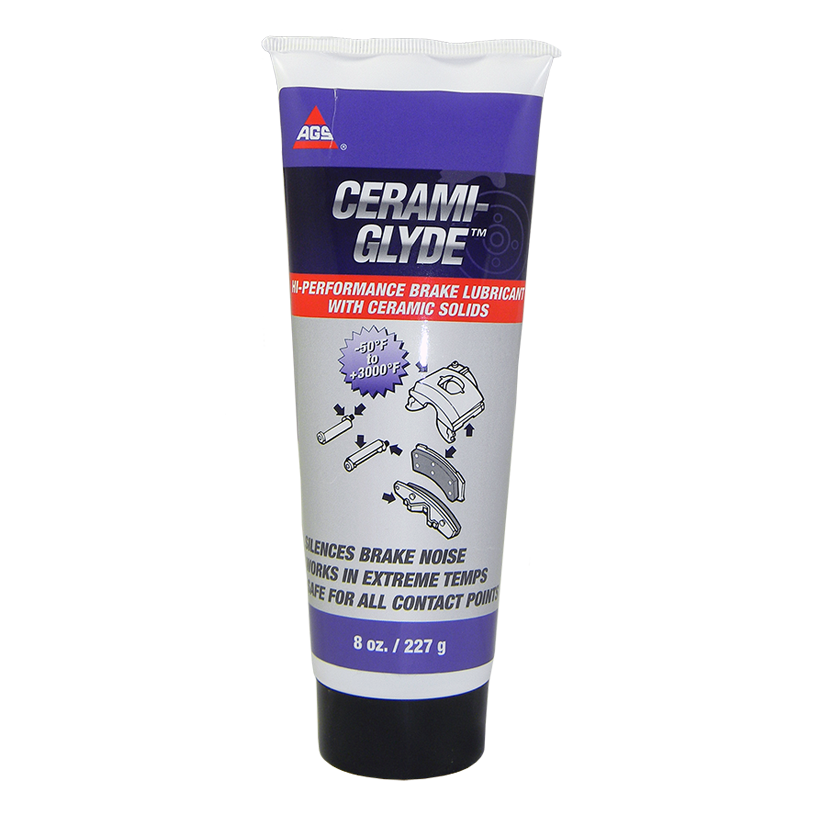

I'm not sure what benefits there are of any for the "ceramic" formulations but AGS who makes Syl-Glyde also make a ceramic silicone version as well called Cerami Glyde. 🤷‍♂️ Ceramic is such a buzz word these days - next there will be a graphene formula.
They come and go don't they? I remember when HD and 3D were big and they were talking about toothpaste.
Ceramic solid additives eh? So we're adding heated and ground clay to our lubricants now? It makes sense on pads, but as a lubricant? I don't know. If graphite is a good dry lubricant because it is so fine of a powder, maybe dried clay is too.

Two things about this.
Ceramic can hold molten iron. It has got to be handled somehow right? It is what they use for atmospheric re-entry heat shields, so I can see the temperature withstands parameters being true.
However, if brakes are getting anywhere near 3000°F, well, you said it with "Molten Iron". There isn't going to be much more than the pads to lubricate.
