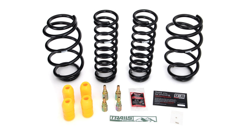

I got a 2nd reply from Grimmspeed here are the spring rates and what the kit would do for the Outback Wilderness:
Khang D. (GrimmSpeed)
Jun 24, 2022, 3:06 PM MDT
I have just spoken with our engineering department on this. With our Lift Kits for your Outback Wilderness Edition, you will only be getting around a 1.5" Lift after installation. The spring rate for our Lift Kit springs are 215 lbs/in in the front and 260 lbs/in in the rear and utilize a linear spring design. Unfortunately, we do not have information gathered whether or not our Lift Kit spring rate is stiffer then the OEM springs on the Outback Wilderness Edition. Hope this information helps, let me know if you have any further questions!
Thanks,
Khang Dao

With the car unloaded, ground clearance at the lowest part of the exhaust pipe is about 11", although I won't be surprised if clearance decreases a tad after the springs break-in.
In my opinion there is a slight improvement to the ride quality. So far I'm pleased with the kit and would do it again.

I also installed the Grimmspeed trails kit. I've had it on the car since mid November - installed by the dealership, along with my prinsu rack, sway bar, strut brace and adjustable endlinks. Only issue during install is that one of the strut extensions broke in half when tightening. The manufacture rushed replacement parts and the install was completed. I've put about 5k miles on the car since then, no major issues and mostly highway miles (and one camping trip with rooftop tent at the beach).
Unfortunately last night I had a major malfunction and car is currently in the shop getting looked over. Driving on typical streets at lower than typical speeds transitioning to a side street with a slight grade change, we heard a pop and clunk sound. From the pictures you can see the bent strut and the wheel is now leaning inwards at the top.
I'm interested to see if the strut extension or end link is damaged as well. Will send an update once I figure out what all went wrong.
This car has never seen any crazy speeds, off-roading (other than the beach) or heavy trail driving, and I don't ever remember hitting anything major in the road since having it and I am the first owner of the car.
I am not sure the best path forward as the dealership is not assisting further (they declined to assist me and said any damage would not be covered) and I have it at a local shop instead. The local shop has concerns about putting in a new strut with this kit (if not damaged itself), they would prefer built struts to install. I am leaning towards Flatout GR Lite, but they are 5 weeks out and can't wait that long. Any recommendations are welcome.
UPDATE: Shop called me and let me know that both front struts are bent, drivers side is just significantly worse. They stated that they think the issue is that the stock strut isn't built to handle the stress of the springs with extension. No other damage that they saw and the rear has no visible issues. I am trying to figure out a solution to temporarily get the car road worthy (if possible) to decide on a replacement lift kit.
