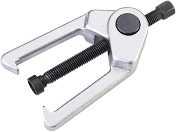

So the cone was a part of the control arm casting. Note it will stay in the arm if the removal is done with the type of tool shown in the service manual. Perhaps the same puller can still be used to separate the cone if there is enough room? In any case, there has to be a tool that will fit, such as OTC 7503 (which I used many times) or another puller from their front-end kit.
if its coming out with ease I would have to test using this by having the inner lips hold onto the wide diameter of the cone and press out the bolt portion

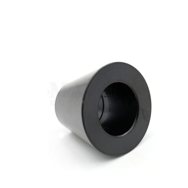

You can buy those cone spacers from the dealer. We have had to get a few new ones at ours due to them being stuck to the ball joint. Not sure their part number, but a good parts person can get them for ya. You can ask them to call their parts support for ya. If I remember to ask, I will see if I can get you a part number or see if the older part is the same.
Edit, BTW its called a Boss transverse link. Weird name for a spacer.
Edit #2.
Heat to the cone and air hammer to the ball joint shaft may release it. 2020 and up we haven't replaced many ball joints yet.
