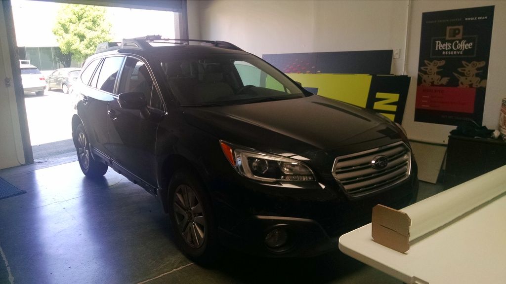

Wrapped wife's car over a few free days at the shop, thought I'd post pics for any of you who are thinking of:
a.) debadging the rear - seriously so many emblems in the back! esp if you've got a PZEV model, its so busy!
b.) blacking out your front grill with something other than plasti-dip while retaining the chrome surround
c.) having a black roof and/or blacked out door handles
d.) wrapping your car
Car was originally (well, technically still is) Crystal Black Silica. Had a few yards of Satin Pearl White laying around that wasn't going to be used, which unfortunately wasn't enough to fully cover all the panels in one piece, so a couple had to be done in two pieces. Left the roof black, along with door handles and mirrors, let me know what you think!
gonna put on some yellow lamin-x film over the fogs sometime...
before: (excuse the poor photo skills... besides, you all know what stock looks like)

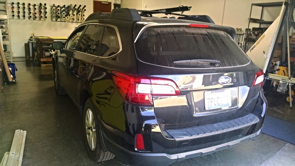

debadged rear gate in black:

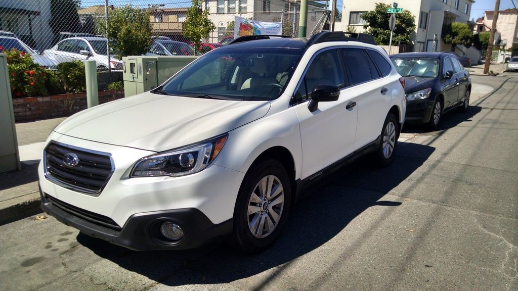

after:

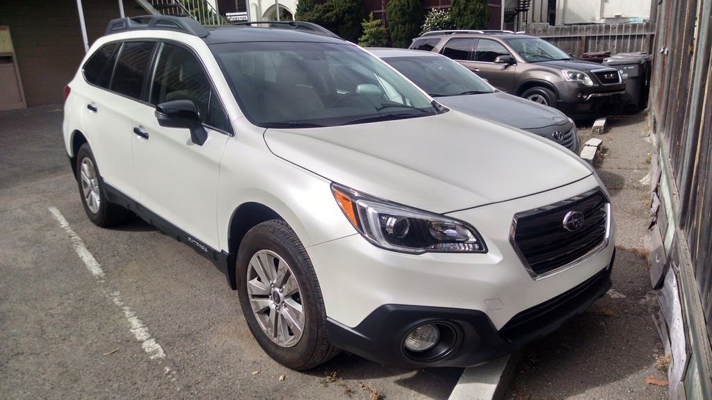

debadged rear gate in white

2 strips of 3m gloss black on each slat, cut out the emblem
